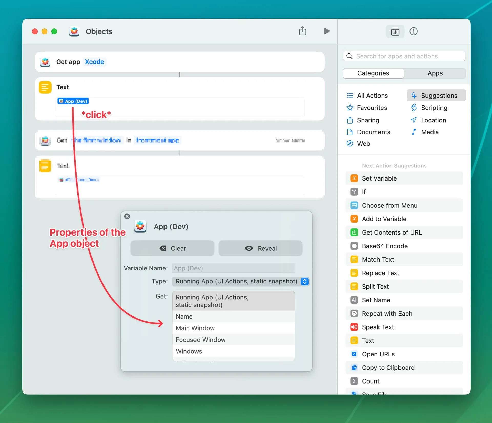

Many UIA Shortcuts actions return objects which aren't simple YES/NO, string, or number values – they contain certain properties about themselves as key-value pairs. Each of those objects represents a "thing" in macOS:
For example, the Get App action will return a Running App object that contains the list of the app's windows, or whether the app is currently frontmost.
Screenshot of the Shortcuts editor, showing the 'Get App' action result's properties overlay

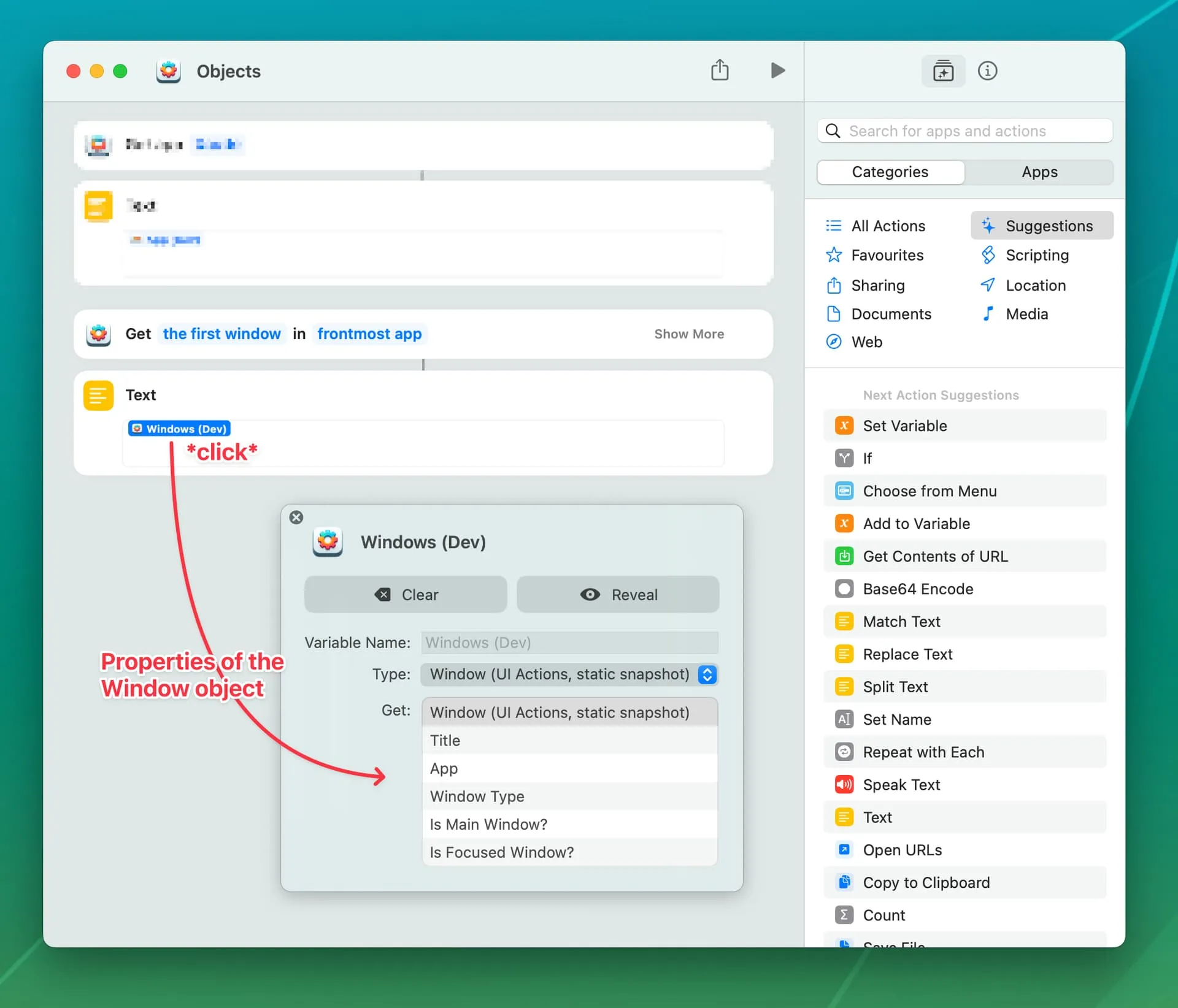

Also, many window-related actions return Window objects that contain infos about the underlying window, such as min/max state, the type of window it is (floating or standard), its size etc.
Screenshot of the Shortcuts editor, showing the 'Get Window' action result's properties overlay
Several actions accept these objects as input, e.g., Minimize Window or Select Menu Item. This way, you can chain actions together to create more complex workflows.
